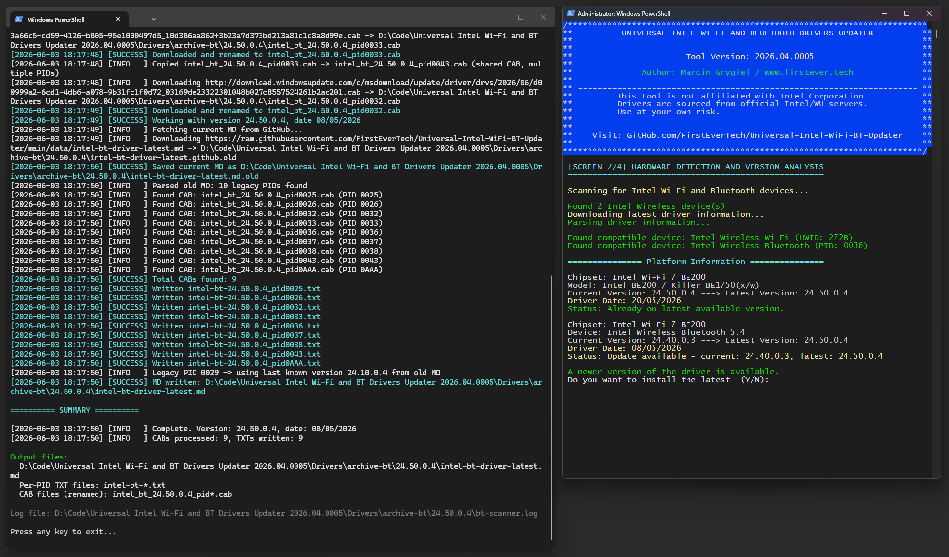

Update: Added new Intel Bluetooth Driver 24.50.0.4
In the latest driver release I discovered that Intel has introduced a new Bluetooth device ID: USB\VID_8087&PID_0043.
Exciting, right? A brand new Bluetooth chipset?
- Nope.
It's actually just another variant of USB\VID_8087&PID_0033 (AX211), using exactly the same driver package.
What's interesting is that this is the first time I've seen Intel assign two different Bluetooth PIDs to a single CAB package.
Unfortunately, this also happened to break the automation logic in my Universal Intel Wi-Fi and Bluetooth Drivers Updater, which assumed Intel would continue following the pattern they've used for years.
A few minutes later, the driver scanner had already been updated to recognize this new exception. To keep the updater itself unchanged, I ended up adding a second AX211 entry and mapping both 0033 and 0043 separately. So if anyone is wondering why there are now two AX211 Bluetooth devices in the database: intel-bt-driver-latest.md
Ask Intel. 🙂

Update: 10/06/2026
v2026.06.0006 → Release Notes
🆕 Highlights
🐛 Bug Fixes
🔧 Compatibility
🆕 Highlights
- New Hardware Support — Added full support for Intel Bluetooth PCI Enumerator devices (`PCI\VEN_8086&DEV_A876`, `4D76`, `E476`, `E376`), also known as Intel(R) Bluetooth(R) PCI Enumerator
- Unified Driver Management — The updater now detects both USB Bluetooth (via `VID_8087&PID_xxxx`) and PCI Bluetooth (via `VEN_8086&DEV_xxxx`) and fetches the appropriate CAB package
- Shared PCI CAB — All PCI devices share a single CAB file (`intel-bt-<version>_pci.cab`), greatly reducing download size and simplifying maintenance
- Updated Banner — New tool version, revised author line, removed redundant GitHub link, improved layout
- Code Cleanup — All comments are now in English, version bumped to `2026.06.0006`
🐛 Bug Fixes
- Missing PID `0043` — Intel AX211 USB Bluetooth (PID `0043`) was absent from the supported device list; affected users received no update offer despite the driver being present in the database
- False Legacy flag for PCI Bluetooth — PCI devices such as `DEV_A876/4D76/E476/E376` were incorrectly shown as `[LEGACY]` when the USB Bluetooth version was newer; PCI and USB now use independent version tracks
- Scanner dead code (v4.5) — PCI legacy fallback in `BT-Platform-Scanner` was unreachable; known PCI DEVs absent from the current leak file now correctly fall back to the last known version from the previous MD
🔧 Compatibility
- Fully backward compatible with older `intel-bt-driver-latest.md` that only contains USB devices
- Existing USB Bluetooth devices continue to work without any changes
