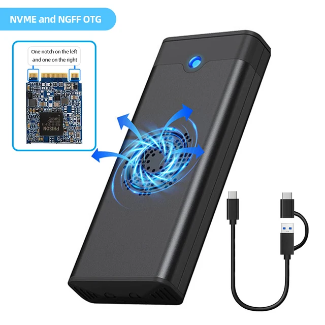

I'd like to ask if anyone has purchased a similar version that comes with a fan?
The original firmware was 1.32.16, and I flashed the latest version, 1.32.87. Originally, the fan would spin, but now it doesn't. I asked the seller, and they said that this temperature-controlled fan is not related to the firmware; it should activate when the temperature is high. However, I feel like it might not be the case.Below is my original configuration file.

I've already tried adjusting the fan settings, hoping it would start working after the firmware update, but the values still show as "n/a" after the update. I hope someone who has purchased a similar device or other friends can help me out! Thanks!

It is possible that it is not linked to the firmware and that it has a CTN or a probe, you will have to check with a hair dryer to see if it triggers

Enclosure with or without fan On=0x1 Off=0x0
FAN = 0x0
In your new Settings you turn Fan off
Find the difference between yours two config her : [url] www.diffchecker.com/mUiHLaxf/ [/url]
This are the right Settings:

FAN : 0x1
