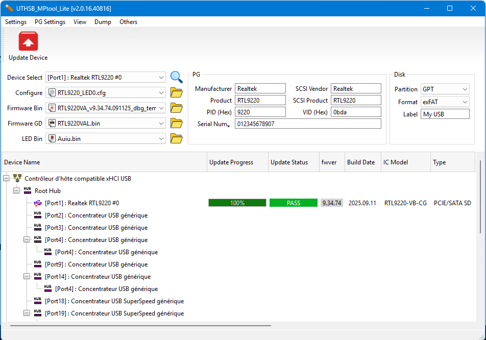

Hi, New Firmware RTL9220 & 9210CN Version 9.34.74
This firmware supports the RTL9220VA/VB series and the RTL9210CN (select the correct CFG file).
RTL-9220 Nvme/USB 3.2 Firmwares
Ultima edição : 5 meses 1 hora atrás por admin.

4 meses 4 semanas atrás - 4 meses 4 semanas atrás
Boitier Sabrent
Warning!! On the Sabret case shown above, as with others, you will lose the RGB animation of the case (if it exists); only the activity light will work.
Before flashing, you unchecked LED in the menu?
  • Desligado
  • Mensagens: 683
  • Thanks: 450
Yes, but unfortunately that also erases the LED firmware.
Sadly, this failed on my Jeyi 2230 RTL9210CN enclosure. Now, it's dead. Red LED shines, but MPTool does not see it anymore. /edit: now red LED does not even come up anymore.
