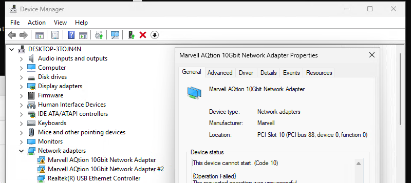

How can I flash this onto dual 10G? Is this the wrong firmware?
[INFO] Checking for Marvell network driver... [DEBUG] PnpDevice Query completed for Marvell devices [DEBUG] Found devices count: 2 [SUCCESS] Found 2 Marvell device(s) Device #1   Device ID: PCI\VEN_1D6A&DEV_04C0&SUBSYS_00011D6A&REV_03\4&31FB88A&0&00E6   Driver Version: 3.1.11.0   Provider: Marvell   INF File: oem1.inf   Status: Version OK (3.1.11.0 >= 3.1.11) Device #2   Device ID: PCI\VEN_1D6A&DEV_04C0&SUBSYS_00011D6A&REV_03\4&2570C98F&0&00E4   Driver Version: 3.1.11.0   Provider: Marvell   INF File: oem1.inf   Status: Version OK (3.1.11.0 >= 3.1.11) [SUCCESS] Driver version check passed [INFO] Enumerating NDISIO devices... [DEBUG] Executing: C:\Users\me\Downloads\40d1b2d8Marvell_AQC113_1.5.18(station-drivers.com)\FirmwareUpdate_v1.5.48\listDevices.exe [DEBUG] listDevices.exe output: listDevices x86_64-w64-mingw32-5.0-3-gfaad6c70  Available devices for NDISIO family:     NDISIO:04C0-058:00.0     NDISIO:04C0-057:00.0 [DEBUG] Parsed NDISIO device IDs: NDISIO:04C0-058:00.0 NDISIO:04C0-057:00.0 [SUCCESS] Found 2 NDISIO device(s) [INFO] Checking for Dual 10G devices... [DEBUG] Device: NDISIO:04C0-058:00.0, Bus Number: 88 (0x058) [DEBUG] Device: NDISIO:04C0-057:00.0, Bus Number: 87 (0x057) [DEBUG] Found Dual 10G adapter: NDISIO:04C0-058:00.0 (0x58) and NDISIO:04C0-057:00.0 (0x57) [DEBUG] Found Dual 10G adapter: NDISIO:04C0-057:00.0 (0x57) and NDISIO:04C0-058:00.0 (0x58) [INFO] Will process 0 standalone device(s)
I have the "This device cannot start. (Code 10)" Issue.
Device is a "UGREEN NASync DXP6800 Pro".
It might be bricked?
.\kickstart2.exe -v kickstart2 x86_64-w64-mingw32-4.10-110-g0d62bf7 Connected to device '0000-58:00.0' Register 0x00003048: 0xffffffff : 11111111 11111111 11111111 11111111 Register 0x00003040: 0x00000001 written Register 0x00003040: 0xffffffff : 11111111 11111111 11111111 11111111 Register 0x00003040: 0xffffffff : 11111111 11111111 11111111 11111111 Register 0x00003040: 0xffffffff : 11111111 11111111 11111111 11111111 Register 0x00003040: 0xffffffff : 11111111 11111111 11111111 11111111

@chilli8733
Yup. I bricked my QNAP Dual 10G card as this firmware is all pretentious about knowing how to update dual 10G cards but borks them totally.
To all reading this: Do not update your Dual 10G cards with this or previous firmware. The updater is not designed to update firmware in such scenario. If you have firmware dump of previous firmware and know how to reflash it using the JTAG debugging tools then be my guest !
You have been warned.
